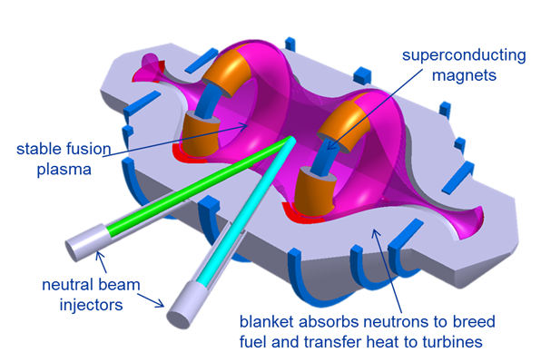

Firma Lockead Martin teda jeho divízia pokročilích projektov Skunk Works si dala patentovať kompaktný fúzny reaktor ktorý može pohánať napríklad stíhacie lietadlo. Prvý funkčný prototyp toho fúzneho reaktoru má byť k dispozícii budúci rok.

jj, PowerPoint znesie vsetko
Z diskusie : Funny, we've been working on fusion since the '50s. Tough problem, nature isn't very obliging. Worked on it myself for several years after grad school before jumping ship to industry.
There is no discussion here about how the fusion reactor works. They show a simple mirror, axisymmetric, with what I presume are neutral beams. This is old hat stuff, rendered obsolete in the '60s by tandem mirrors, by non-axisymmetric geometries, and many more innovations. They appear to think that if they make it small enough and do the correct powerpoint slides, the technology will fall into place. Who wrote this up, a business school graduate?
Color me skeptical.
Color me skeptical.

nie, Rusi hovoria o stiepnom reaktore. Toto je fuzny reaktor - Svaty gral modernej energetiky, zatial stale hudba dalekej buducnosti.
